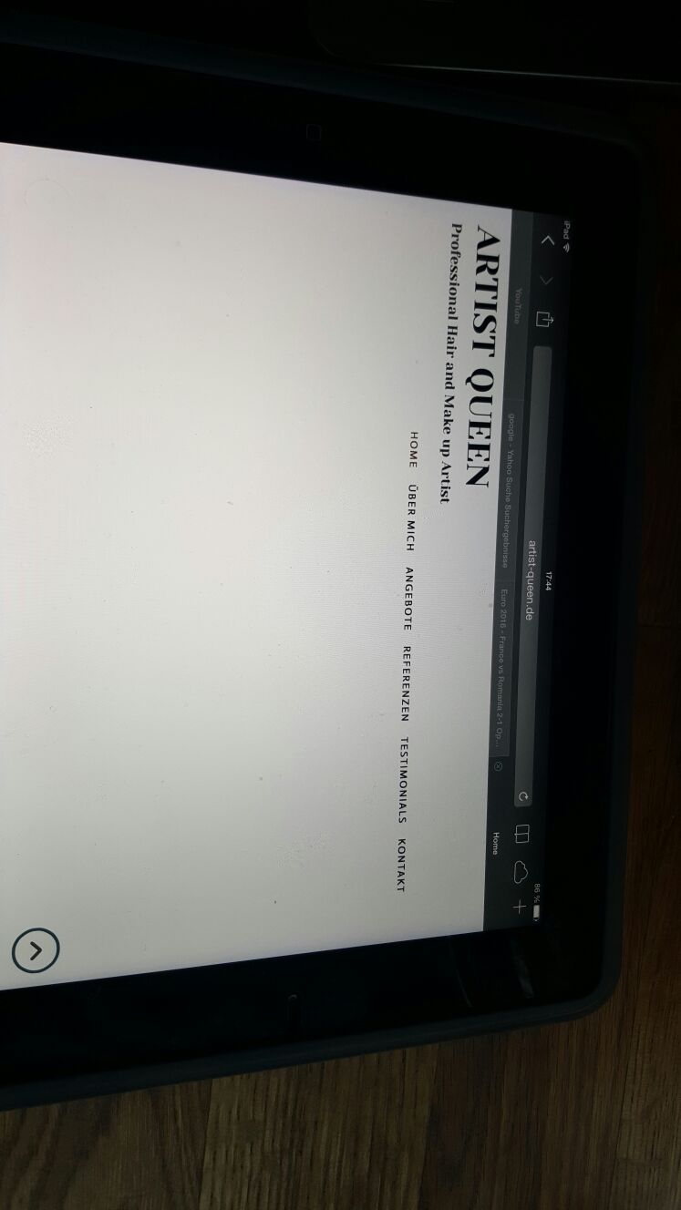

Hello, the website is www.artist-queen.de, I attach a photo my client made with her cellphone
enter image description here
Another website where the google maps isn't working on my clients Apple devices is www.hautaerzte-zentrum.de
Hello, the website is www.artist-queen.de, I attach a photo my client made with her cellphone![enter image description here][1] [1]: http://www.die-designwerkstatt.de/images/WhatsApp%20Image%202016-10-11%20at%2017.46.00.jpeg Another website where the google maps isn't working on my clients Apple devices is www.hautaerzte-zentrum.de

Hello Claudia,
the most probable reason of the problem on Home page is that Height of the Slider control is specified in "vh".
Please try to set it up in % or in pixels. It should help.
Let us know the results.
