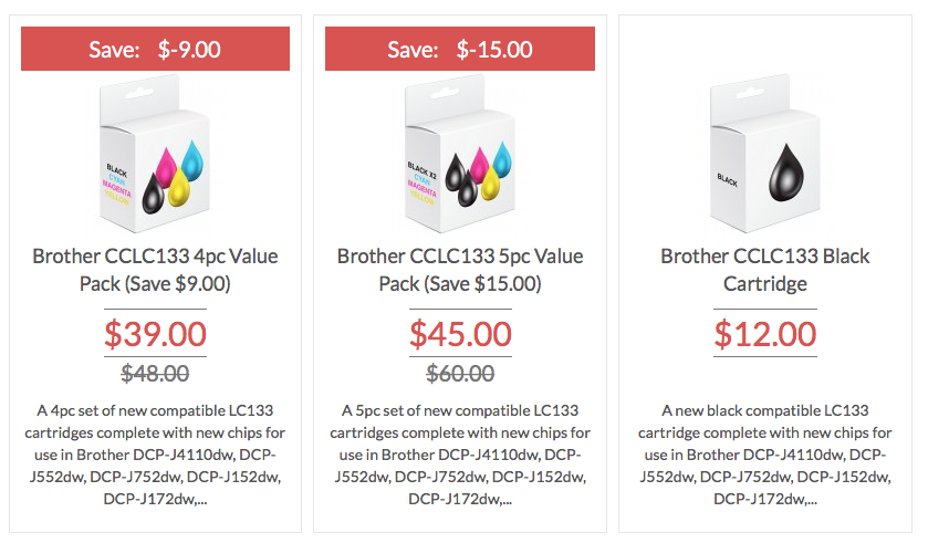

OK, I'll try and make this clearer!
Here in New Zealand we have a Goods & Services tax (GST) of 15%. So the website needs to show the base price plus tax (GST). That is no problem.
The issue is when a product is on sale because you need to be able to show the old price and discounted price. I can only see a way to show the discounted price and then the old price without tax (they need to both include the tax).
Also if you have 'show old price' selected, it will show the price without tax on non-sale items as well.
Here is a mock up of what I'm after - all prices are with tax for both sale and non-sale items.
Here is the shopping cart which does display the totals correctly
I can achieve this with the native virtuemart template (and all other shopping carts I've used) but not with Themler.
