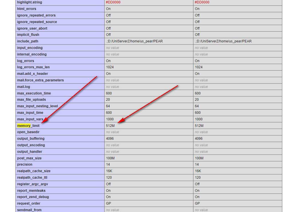

Why do I get this so often after latest few updates ?
I have 512 MB of memory. (PHP version is 7.0.1 stable)
enter image description here
PHP Memory Configuration Error
Themler requires at least 64Mb of PHP memory. Please increase your PHP memory to continue. For more information, please check this link.
Why do I get this so often after latest few updates ? I have 512 MB of memory. (PHP version is 7.0.1 stable) ![enter image description here][1] [1]: http://attachments.answers.billiondigital.com/169/21169/2016-10-29-173948.jpg PHP Memory Configuration Error Themler requires at least 64Mb of PHP memory. Please increase your PHP memory to continue. For more information, please check this link.

I added this line in wp-config.php despite it should not be done. And Memory error comes more and more often.
define('WP_MEMORY_LIMIT', '100M');
I added this line in wp-config.php despite it should not be done. And Memory error comes more and more often. define('WP_MEMORY_LIMIT', '100M');

I disabled few Apache cache modules. Maybe they make problems. Will see how it goes.

Seems as those Apache modules made problems with Memory. Solved, seems as. Will know better after few days.

Some update. Reinstalled all localhost servers and controls. Compared files for changes and differences.
Because problem got back.
Seems as on default PHP servers has activated opcache and sessions cache on default (PHP 7.x), but stupidly in Apache it was deactivated.
If you use those two activate them in Apache too. PHP 7.x works somehow differently and gives Memory limits fatal errors.
Read info found in Google. Those modules are not named logically, and it is easy to miss them, or miss connection between them and PHP modules.
Some update. Reinstalled all localhost servers and controls. Compared files for changes and differences. Because problem got back. Seems as on default PHP servers has activated opcache and sessions cache on default (PHP 7.x), but stupidly in Apache it was deactivated. If you use those two activate them in Apache too. PHP 7.x works somehow differently and gives Memory limits fatal errors. Read info found in Google. Those modules are not named logically, and it is easy to miss them, or miss connection between them and PHP modules.
