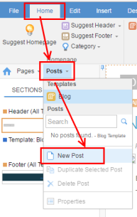

1.create several custom posts using the option

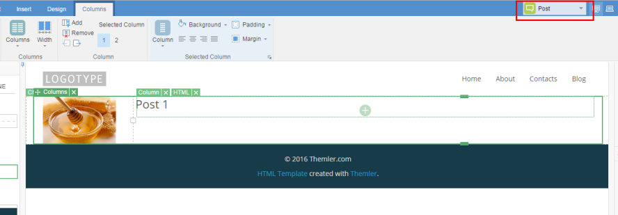

2.add Post content, e.g. Section, Text, HTML, Images, etc.

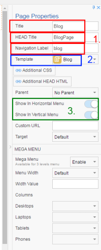

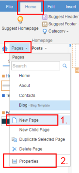

3.create new page and open its Properties
4.in the page Properties change the
-Page Title
-Head title
-navigation label
Change the Template (the most important step)
and make sure that page is added to menus

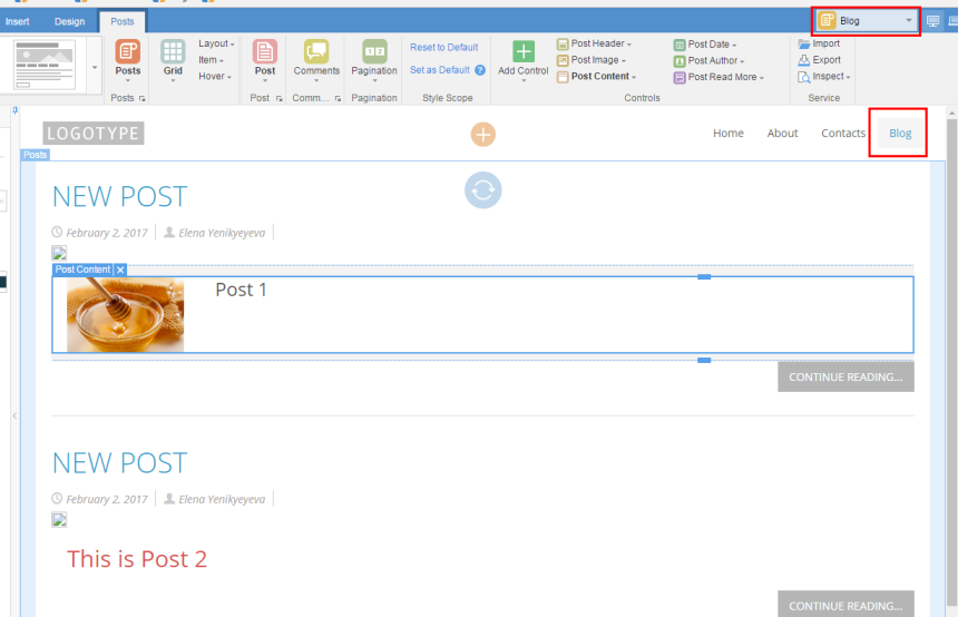

5.as a result you'll get a Blog like
