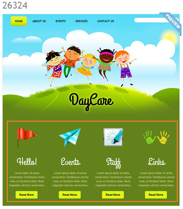

I want to create the same areas Hello, Events, Staff, Links as in this screenshot:
alt text
What should I do for this?
I've tried to add a "Column" control and then four "Box" controls within it, however how I can add content or edit those boxes afterwards?

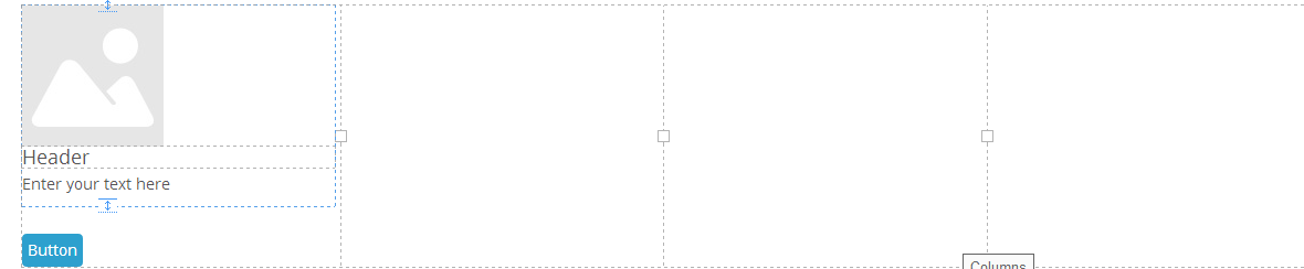

What you can try:
  1. Add columns.
  2. Set layout to 4-column
  3. Add Text Group control to each cell with layout where image is above.
  4. Add Button under each Text Group.
alt text
If you want to transform each cell to Footer Widget Area you should try Add Control -> Other -> Footer Widget Area (one such control is in footer of WP default template). But be aware that Widget Area is just a placeholder for cms-specific widget (which is set up from admin panel), you can't drag any of the Designer's controls there at the moment.
Hope this helps.
What you can try: 1. Add columns. 2. Set layout to 4-column 3. Add Text Group control to each cell with layout where image is above. 4. Add Button under each Text Group. ![alt text](http://attachments.forum.billiondigital.com/48/48/4-cells-text-area-button.png "4-cells-text-area-button.png") If you want to transform each cell to Footer Widget Area you should try Add Control -> Other -> Footer Widget Area (one such control is in footer of WP default template). But be aware that Widget Area is just a placeholder for cms-specific widget (which is set up from admin panel), you can't drag any of the Designer's controls there at the moment. Hope this helps.
