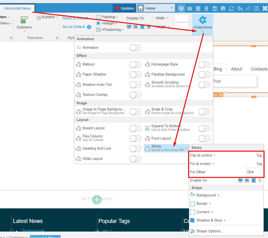

Check that your sticky menu settings are set to Top and 0 offset:
Gina
Themler Support
Hello Eleanor, Check that your sticky menu settings are set to Top and 0 offset: !fixed-menu.png! Gina Themler Support

Hi Gina
thank you for your reply.
yes the settings are as you suggest. It's only an issue on that actual page, the sticky menu on the rest of the site is working fine.
Hi Gina thank you for your reply. yes the settings are as you suggest. It's only an issue on that actual page, the sticky menu on the rest of the site is working fine.
