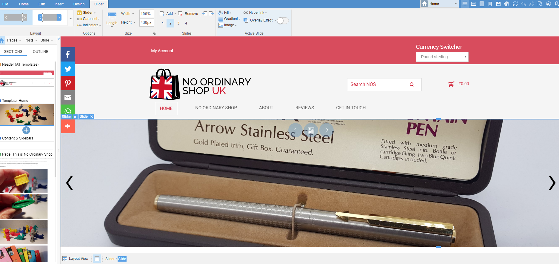

Hi Gina
Thanks for getting back
I can see in FF inspector that bd-sidebar-40 is set to Float Left but it is correctly set to Float Right in Themler Editor and also displays right (See screenshot 01)
I can also see the Slider pic of the pen, that is blank in FF/Edge for me, in both Chrome and the Themler Editor (See screenshot 02 and 03)
If I add the css it makes no difference to the FF Inspector, it still shows left.(See screenshot 4)
Very strange
Cheers
Hi Gina Thanks for getting back I can see in FF inspector that bd-sidebar-40 is set to Float Left but it is correctly set to Float Right in Themler Editor and also displays right (See screenshot 01) I can also see the Slider pic of the pen, that is blank in FF/Edge for me, in both Chrome and the Themler Editor (See screenshot 02 and 03) If I add the css it makes no difference to the FF Inspector, it still shows left.(See screenshot 4) Very strange Cheers

Hi
I've managed to sort of resolve the desktop issue by using FF to edit/save the template in Themler which kicked in the correct display in both Desktop FF and Chrome but not Edge.
However, the mobile version is not showing my social media icons or currency switcher on the right as per Themler Editor(using FF) in both FF Mobile Android, Chrome Mobile Android and Safari Mobile. (See Screenshot 05- Themler Editor in FF Desktop)
Cheers
Hi I've managed to sort of resolve the desktop issue by using FF to edit/save the template in Themler which kicked in the correct display in both Desktop FF and Chrome but not Edge. However, the mobile version is not showing my social media icons or currency switcher on the right as per Themler Editor(using FF) in both FF Mobile Android, Chrome Mobile Android and Safari Mobile. (See Screenshot 05- Themler Editor in FF Desktop) Cheers
