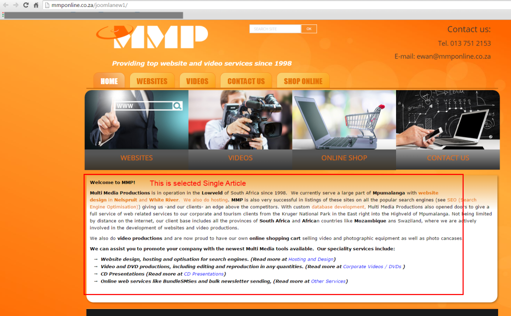

I've just visited the http://mmponline.co.za/joomlanew1/ and I see that home page outputs the article
http://attachments.answers.billiondigital.com/395/4395/JoomlaHome.png

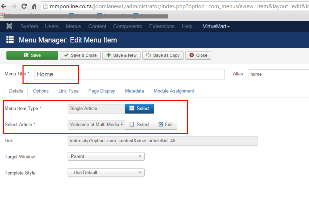

And under Joomla admin back end the Home link is assigned to Single Article
http://attachments.answers.billiondigital.com/394/4394/JoomlaAdminHome.png

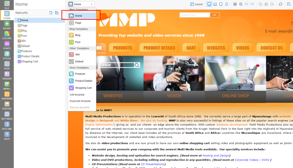

When theme is opened in Themler the Home template also outputs the same article
http://attachments.answers.billiondigital.com/397/4397/ThemlerHome.png

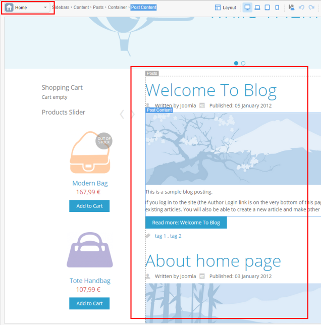

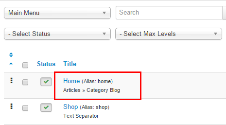

You may also set up the Home page to output the list of posts. To do it you need to configure Joomla Home menu link to be of Category Blog type. E.g.:
Themler
http://attachments.answers.billiondigital.com/399/4399/ThemlerHomePosts.png
Joomla
http://attachments.answers.billiondigital.com/400/4400/JoomlaHomePOsts.png

What you see in the themler backend is not the content from the article in Joomla. It's text that was copied and pasted into the backend due to the fact that there is now way that I can find to link the article in the themler homepage.
Please explain how to do this, as I see no way to link an article on the homepage of themler. There is no way to add a post on this page.
