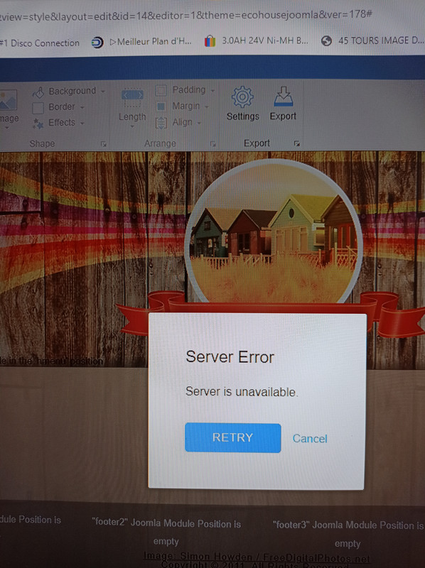

Importing an Artisteer model in Thelmer which comes from your models, it indicates server not found, it leaves the version of the model 178 no update possible.
Importing an Artisteer model in Thelmer which comes from your models, it indicates server not found, it leaves the version of the model 178 no update possible. [Capture-d-cran-2023-08-01-171710.png](https://postimg.cc/QBFC1GC8)

Hello,
Can you open any other theme at the moment? Does the server error happen anywhere else?

Hello, after several tests on different Artisteer themes coming from your site, the update is not possible, it remains in version 178, two errors I have, server unavailable, or or sometimes "please wait, update to the new version, the window flashes for a while without arriving at an update.

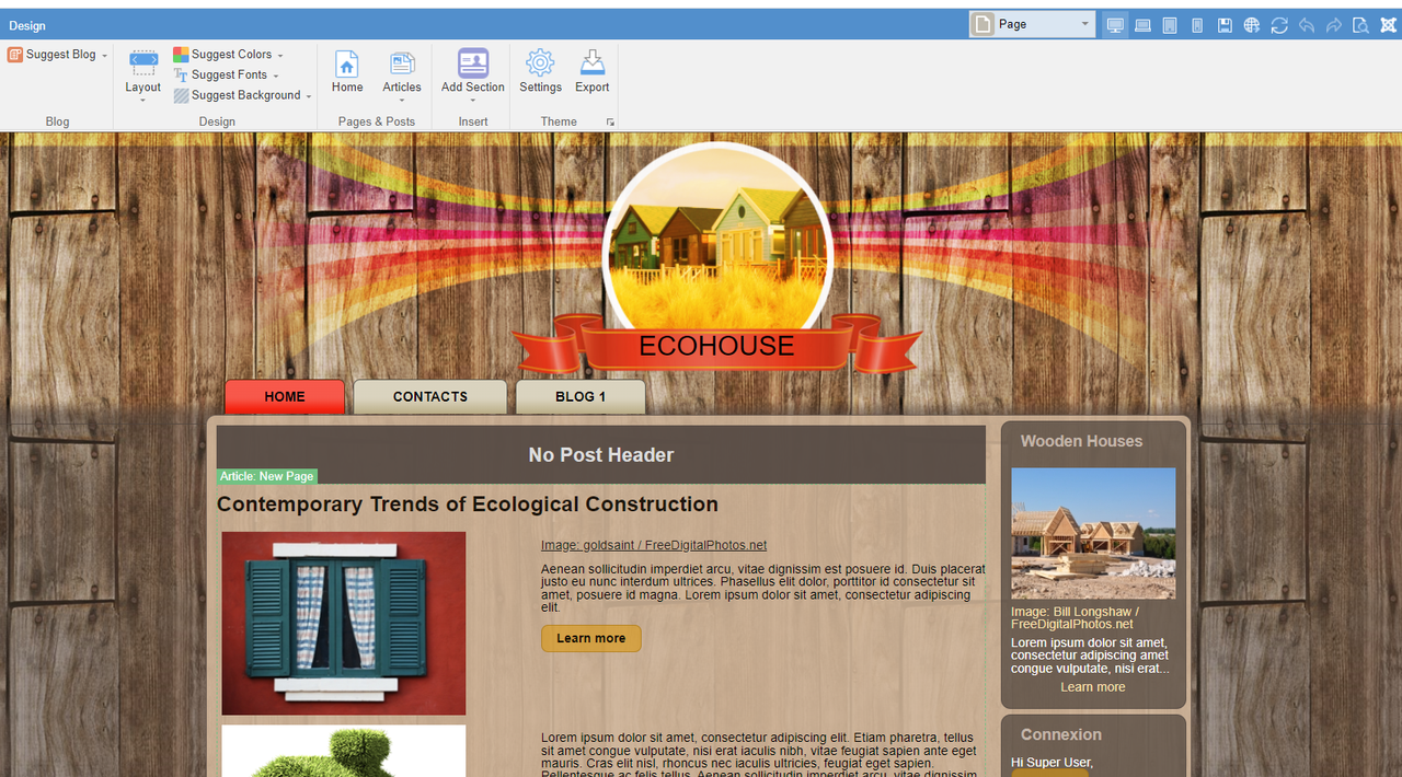

I just followed your method by making a copy with a different name, and recovering my renamed version, indeed Themler does the update to the latest version, once in Themler the articles and menu are displayed very well, but as soon as I preview the Theme from joomla, there is no menu and no article, I just have the top header, even by selecting the hmenu in module nothing is displayed, no Joomla article is poster, I have the version of Artisteer that you indicate.
