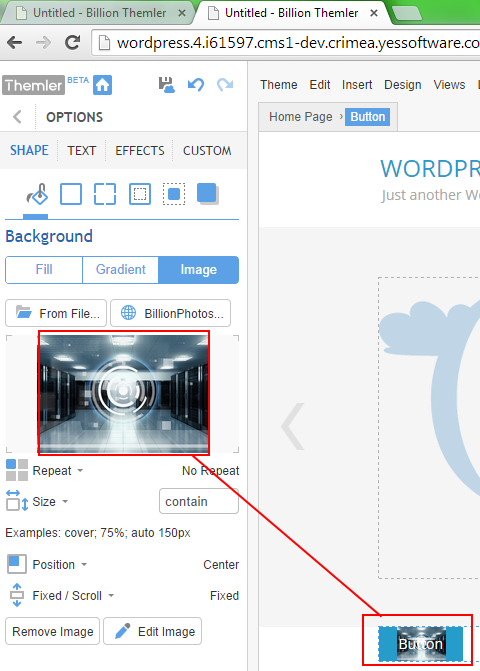

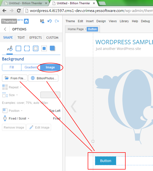

Hi Shaul,
you may add image background for the Button Control. Select the Button control, open Background option
On the Image tab you may select background image for the button.
Here is the result:
regards,
Aileen
