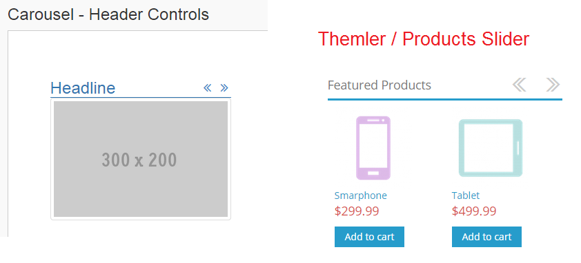

Let's look at Slider examples from http://sevenx.de/demo/bootstrap-carousel
Below are samples how it is possible to do with Themler:
Let's look at Slider examples from http://sevenx.de/demo/bootstrap-carousel Below are samples how it is possible to do with Themler: ![](http://attachments.answers.billiondigital.com/496/496/product-slider3.png)

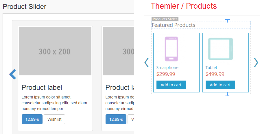

Products Slider
**Products Slider** ![](http://attachments.answers.billiondigital.com/495/495/product-slider2.png)

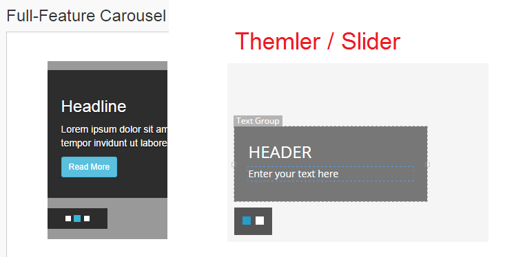

Aleh posted this 10 October 2014
Themler Slider
**Themler Slider** ![](http://attachments.answers.billiondigital.com/497/497/slider.png)

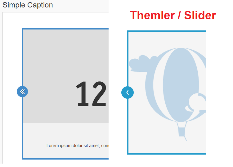

Themler / Slider
**Themler / Slider** ![](http://attachments.answers.billiondigital.com/498/498/slider2.png)

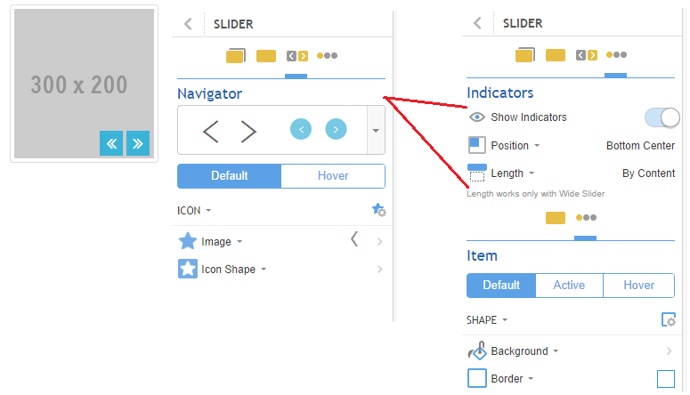

Support Team posted this 10 October 2014
And we are going to add more properties to Navigator.
This will allow to make Slider like below:
And we are going to add more properties to Navigator. This will allow to make Slider like below: ![](http://attachments.answers.billiondigital.com/500/500/carousel2.png)
