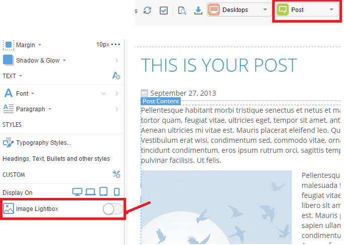

I'd also like to disable the Themler lightbox because it causes troubles with Balbooa Gallery.
But I can't find the toggle button in the screenshot you've posted on 22 October 2014.
You'll find a screenshot how the menu looks in my Themler version (1.0.319).
Can you please be so kind an tell me, where to find the option to disable Themler lightbox?
Thank you very much in advace.
Kind regards,
Robert
Hi, I'd also like to disable the Themler lightbox because it causes troubles with Balbooa Gallery. But I can't find the toggle button in the screenshot you've posted on 22 October 2014. You'll find a screenshot how the menu looks in my Themler version (1.0.319). Can you please be so kind an tell me, where to find the option to disable Themler lightbox? Thank you very much in advace. Kind regards, Robert
Support Team
Support Team posted this 17 January 2017
Hi,
The option is available here:
Thank you,
Olivia
