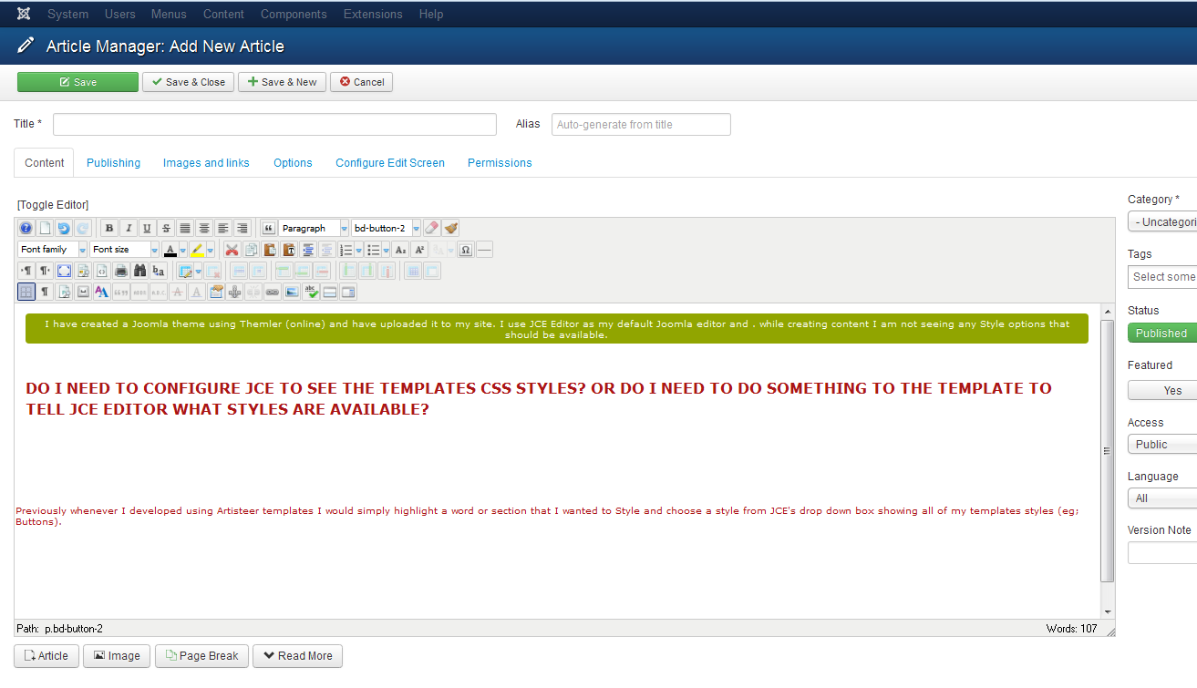

I tested the JCE editor (default settings) with Joomla 3.3 and Themler theme. Please check the screenshot
I successfully selected different styles for different paragraphs using 'Paragraphs' and 'Styles' lists. Please make a couple of screenshots which demonstrate what style you're trying to apply. And attach your Themler theme here.

==================RESOLVED=================
Thanks for checking on this issue Aileen. I could see your JCE looked to be working and I could see all of the Style options available to me if I switched to the TinyMCE Editor so I focused on my JCE configuration.
I found that the "Compress CSS" option in JCE's Global Settings to be at issue. If I disabled the CSS compression then the Style options worked.
