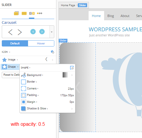

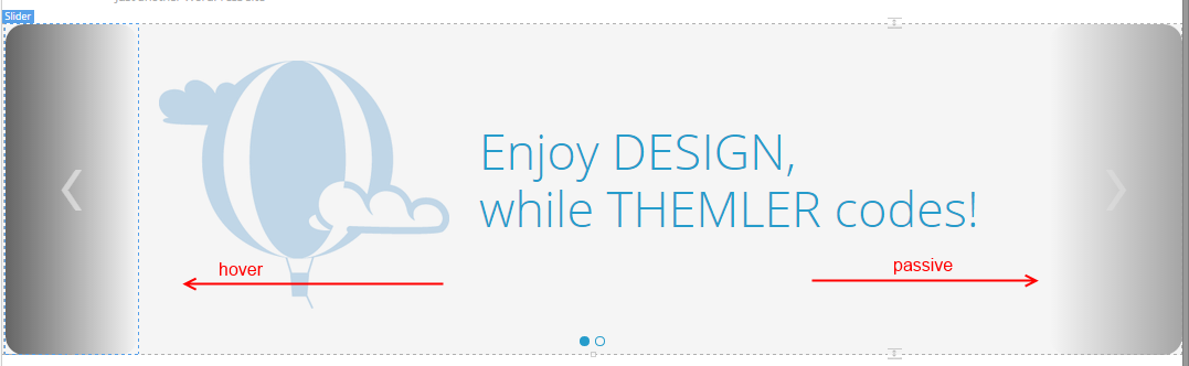

Hi Shaul,
I think if you add maybe the shadow of corners in themeler's slider it would be great, (as an option to turn on or off ofcrouse), you can see what I mean here: http://getbootstrap.com/examples/carousel/
Actually in the example above the shadow you're referring to is simply a shadow of the slider navigation controls. It has different opacity on hover. That's all. You can make the same effect in Themler.
  1. Add padding to the Slider Carousel Shape. I've tried padding: 170px 50px;
  2. Add gradient to the Slider Carousel Shape with Angle 90deg.
  3. Then Slider Carousel >> Shape options >> Custom >> Opacity: 0.5
  4. Now you simply need to add different opacity on Hover state: Slider Carousel >> Hover >> Shape options >> Custom >> Opacity: 0.9
    Result:
If you wish you can add transition effect on hover.
