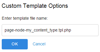

We've added an option to specify the name of the template of "Custom Template" type in the same way as you can do in WP theme:
where my_content_type is a machine name of your custom content type. In the same way you can specify taxonomy term:
page-node-taxonomy-term-4.tpl.php
Currently this feature is on testing stage. It's planned for the next major Themler update.
If you have any further suggestions regarding this issue please let us know.

so to be clear - themeler will generate a tpl file for the content type and we can edit as needed. one question - if we edit, will the changes in themler overwrite?
> Hi guys, > > I have some news. > We've added an option to specify the name of the template of "Custom Template" type in the same way as you can do in WP theme: > > ![](http://attachments.answers.billiondigital.com/747/6747/drupal-content-types.png) > > where `my_content_type` is a machine name of your custom content type. In the same way you can specify taxonomy term: > `page-node-taxonomy-term-4.tpl.php` > > Currently this feature is on testing stage. **It's planned for the next major Themler update.** > > If you have any further suggestions regarding this issue please let us know. > > Thank you, > Olivia so to be clear - themeler will generate a tpl file for the content type and we can edit as needed. one question - if we edit, will the changes in themler overwrite?
Support Team
Support Team posted this 29 October 2015
Hi,
For example you have "fruits" content type.
You create custom template with name page-node-fruits.tpl.php. This template will be used for all contents of the "fruits" content type.
These templates are alternative to Default template used for custom content types by default.
If you edit this tpl manually and then save theme it Themler the custom changes will be overridden. Just like with any theme file. This is a regular Themler template that can be edited in Themler (like Page, Post, Blog, etc).
Thank you,
Olivia
