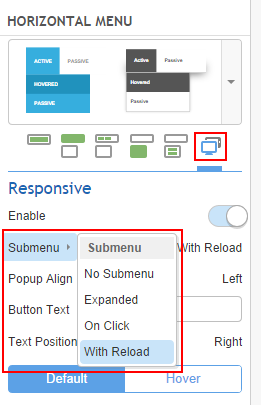

Hello,
We've reproduced the issue with submenus on our side. It should be fixed in the suture Themler updates.
Thank you,
Olivia
UPD: the issue is related to OnClick option. The other options (Expanded and With Reload) work ok:
Please try one of these options.
UPD: the issue is related to OnClick option. The other options (Expanded and With Reload) work ok:  Please try one of these options.Hi,
We have just updated Themler and this update includes the fix for the issue. But there is still one more issue with opening the whole responsive menu in Joomla. We're working on it.
