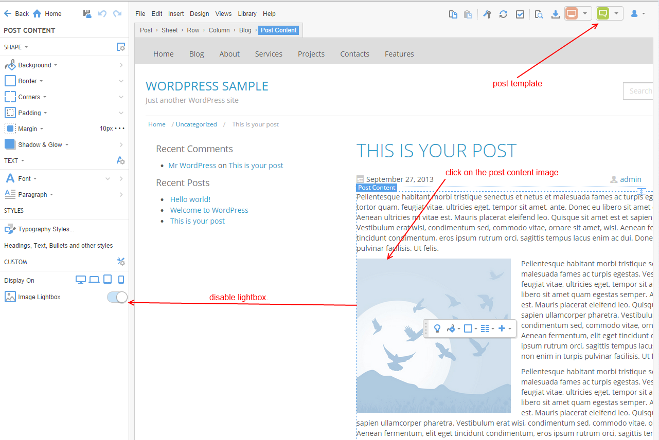

Hello
I can't find an option to disable lightbox for wordpress POST content images.
Please see the attached image:
Please let us know if you have any other questions.
Thank you,
Olivia

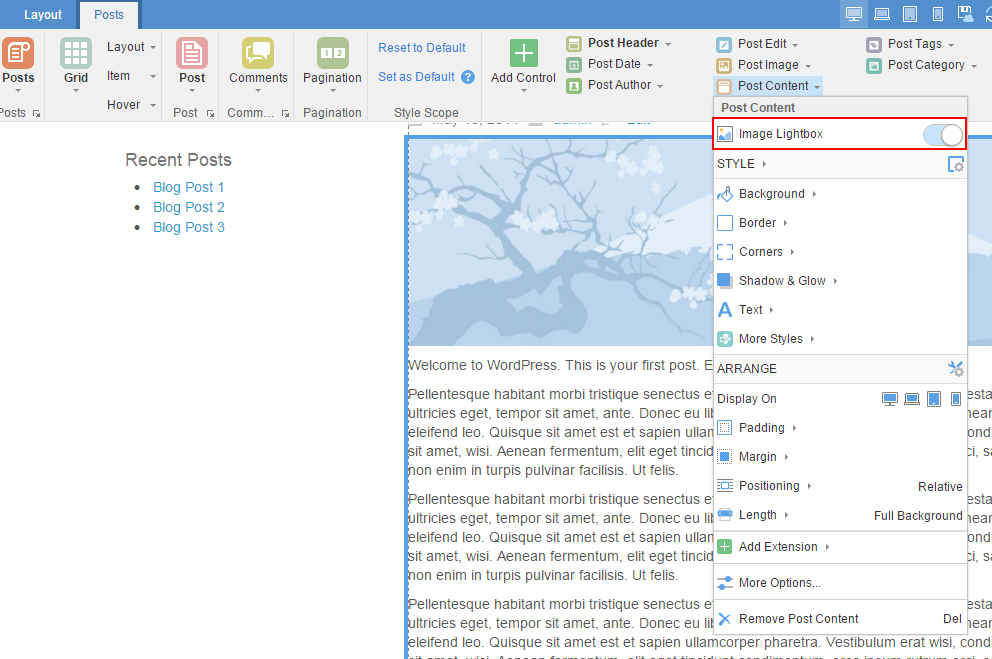

Yes, it is available:

Hello Erwin,
the Content includes Post control, Post Control includes Post Content for which you may disable/enable lightbox

Yes, it is still available here:
