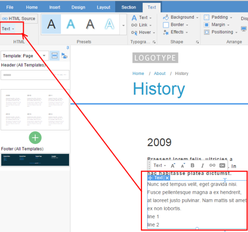

if I use the inline editing and add a "Enter" it adds DIV and i think that is the problem for the text that disapears...
my workarround is to put html code in the container "<br>" as necesary,
if I use the inline editing and add a "Enter" it adds DIV and i think that is the problem for the text that disapears... my workarround is to put html code in the container "&lt;br&gt;" as necesary,

if Text control type is detected as "text"
The DIV tag should not be added when you press Enter inside the text. But &lt;br&gt; should be added.
Could you provide step by step description including couple of screenshots?
And when exactly the text disappears?
