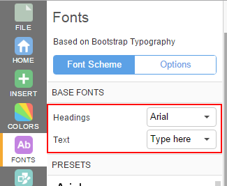

  1. upload your font to the server
  2. add @font-face to the Themler Settings >> Additional CSS
  3. go to Fonts tab and type font family in the appropriate field:
    Now you can specify this Font Family for text in Themler.

Add you font ass additional CCS in Home > Settings menu, using code like this :
<pre>
@font-face {
font-family: "CDUKievit";
src: local("CDUKievit"), url("http://cdu-hochlar.de/templates/untitled_160127_160/css/CDUKievitWeb-Medium.woff&quot;) format("woff");
</pre>
Then, choose your font in Designer > Fonts > Font Options menu
