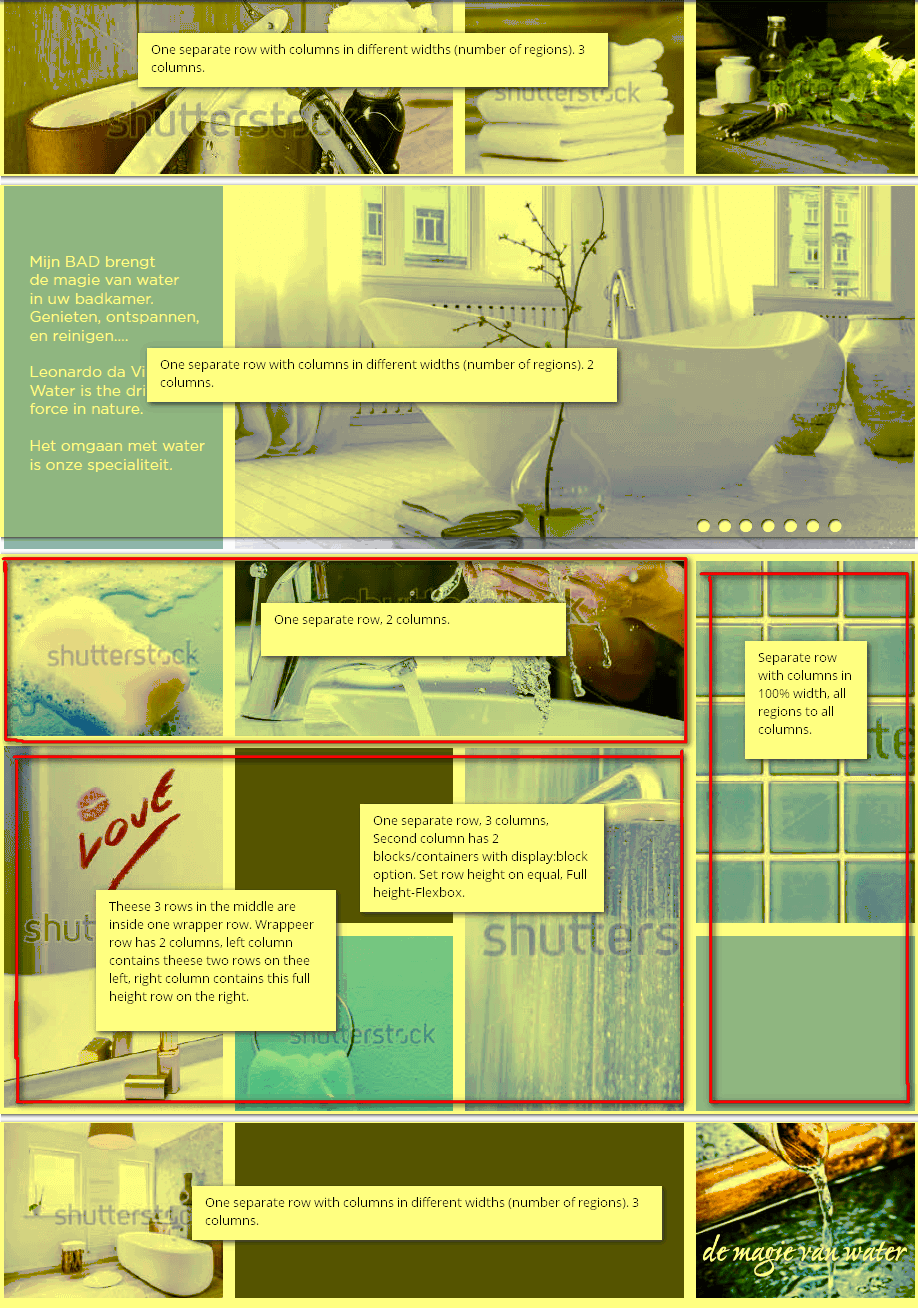

Here is a screenshot. There are many ways to get this layout, I tried with most simple as I think it is. Depends much on what is your content for columns, and how do you want it to behave in small devices. It is up to you to fix it.
http://attachments.answers.billiondigital.com/347/7347/themler.png
Here is a screenshot. There are many ways to get this layout, I tried with most simple as I think it is. Depends much on what is your content for columns, and how do you want it to behave in small devices. It is up to you to fix it. ![http://attachments.answers.billiondigital.com/347/7347/themler.png][1] [1]: http://attachments.answers.billiondigital.com/347/7347/themler.png

Dont try to force width in percentage % for columns, just use number of Bootstrap regions for column/s. With percentage you will make a mess of it.
