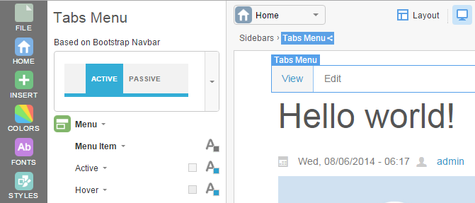

Please make sure that you added Tabs Menu control (Insert tab >> Navigation):

Similar question: Tabs Menu (View, Edit) is only displayed for the "Home" page, and not for other content. How to be? The site editor can not edit the material. (Drupal 7, in Administrator mode)
Tabs Menu is embedded in the Sidebar. it shall be displayed on all pages?

I`m added Tabs Menu under CMS Content. Result:
- template Home = menu is displayed at Home page,
- template Page = menu is displayed in content Page
- template Blog = menu not displayed but is listed in the left Themler column,
- template Post = has no effect,
- template Default = Eureka! Menu is displayed in other content.
(How many problem waiting for me more?..)
Hence the question: why do I need all these sufferings, why should I waste so much time?
I need only two template: Home and Default.
Please, give the opportunity to remove all the unnecessary templates! Where can I vote for this question?
