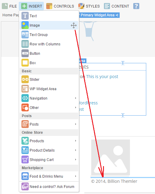

Actually Footer control already works in right way.
1. Insert Image control into Footer
2. Switch to different template
You will see the same Footer content.
Actually **Footer** control already works in right way. 1. Insert **Image** control into Footer 2. Switch to different template You will see the same Footer content. !insert-footer.png! !footer-share.png!
