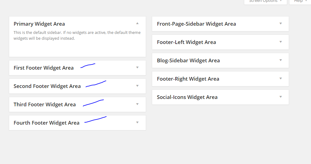

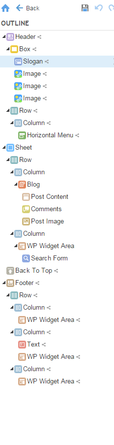

I created my own Widget Areas and named them appropriately but there are still some that remain when I go to Wordpress Widget area specifically called
First Footer Widget Area
Second Fooder Widget Area
Third Footer Widget Area
Fouth Footer Widget Area
I do not have those defined in themler so not sure where they are being picked up from. I attached my outline in themler along with what I see in the wordpress backend. The Widget areas I have defined the the ones you will see that I named.

Brian,
These areas are standard WordPress' and cannot be deleted:
Primary Widget Area
Watch in this video:
https://www.youtube.com/watch?v=yf-NkMPI7NY
Thanks,
Oleg
Brian, These areas are standard WordPress' and cannot be deleted: Primary Widget Area First Footer Widget Area Second Fooder Widget Area Third Footer Widget Area Fouth Footer Widget Area Watch in this video: https://www.youtube.com/watch?v=yf-NkMPI7NY Thanks, Oleg
