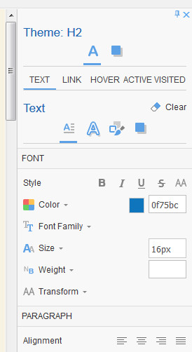

Hi,
This is one thing I cannot find and wish to change it.
Please try changing this padding:
The H1 & H2 styles have margin top and bottom but no such option in the H2 settings.
Please check Spacing Before and After in the same dialog:
To remove the margin set spacing to 0 or type desired value.
Thank you,
Olivia
Hi, > This is one thing I cannot find and wish to change it. Please try changing this padding: !sheet-padding.png! > The H1 & H2 styles have margin top and bottom but no such option in the H2 settings. Please check Spacing Before and After in the same dialog: <img src="http://attachments.answers.billiondigital.com/162/12162/2016-03-17-104321.jpg"> To remove the margin set spacing to 0 or type desired value. Thank you, Olivia

Show me where there are margin or padding options in these H settings? That is the reason I provided the screenshots. There not in there.

H tags padding and margins you remove inside Paragraphs options. Put all on "0" and Line height on "1", or as it suit you.

Another style I cannot figure out. The H1 & H2 styles have margin top and bottom but no such option in the H2 settings. Most other settings have the margin padding in the paragraph options. I do not see them here.
Another style I cannot figure out. The H1 & H2 styles have margin top and bottom but no such option in the H2 settings. Most other settings have the margin padding in the paragraph options. I do not see them here. !2016-03-17-104215.jpg! !2016-03-17-104244.jpg! !2016-03-17-104321.jpg!
