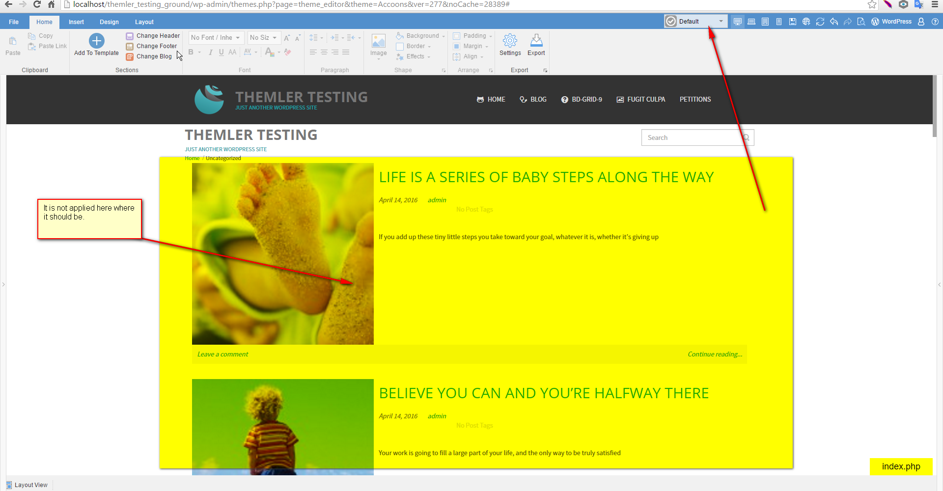

Seems as very nasty bug. Tested on two themes, Accoons from Clipart and one of my own.
Adding Posts layout from Clipart on Archive / "Blog" template switch to Home templete and Posts layout is changed there. Layout from Clipart is applied on Home template. And it is not applied on custom template where it should be. (in case of my testing it was index.php and one custom Archive template).
Seems as very nasty bug. Tested on two themes, Accoons from Clipart and one of my own. Adding Posts layout from Clipart on Archive / "Blog" template switch to Home templete and Posts layout is changed there. Layout from Clipart is applied on Home template. And it is not applied on custom template where it should be. (in case of my testing it was index.php and one custom Archive template).

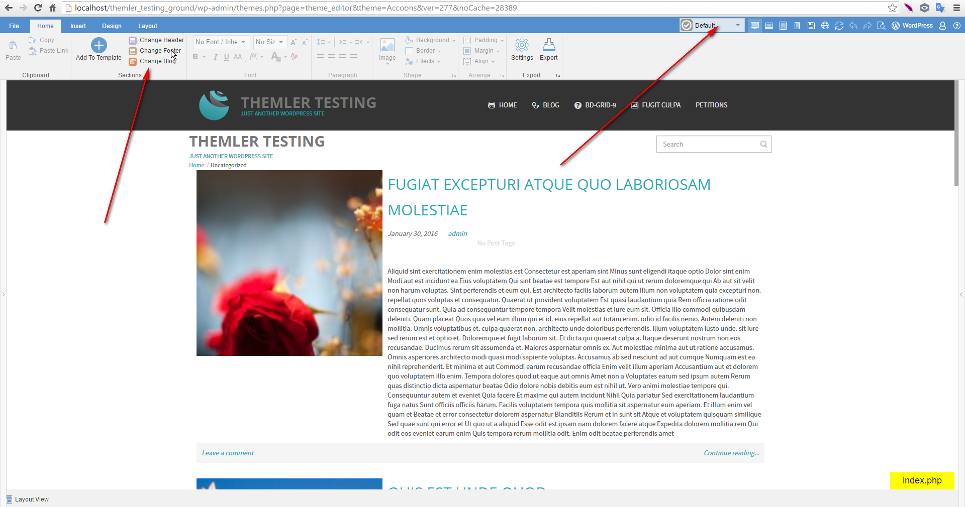

All 3 instances of "Customize template style" are clicked on both templates.
enter image description here
All 3 instances of "Customize template style" are clicked on both templates. ![enter image description here][1] ![enter image description here][2] ![enter image description here][3] ![enter image description here][4] ![enter image description here][5] [1]: http://attachments.answers.billiondigital.com/583/13583/2016-04-14-133353.png [2]: http://attachments.answers.billiondigital.com/584/13584/2016-04-14-133524.png [3]: http://attachments.answers.billiondigital.com/581/13581/2016-04-14-133616.png [4]: http://attachments.answers.billiondigital.com/582/13582/2016-04-14-133728.png [5]: http://attachments.answers.billiondigital.com/580/13580/2016-04-14-133850.png

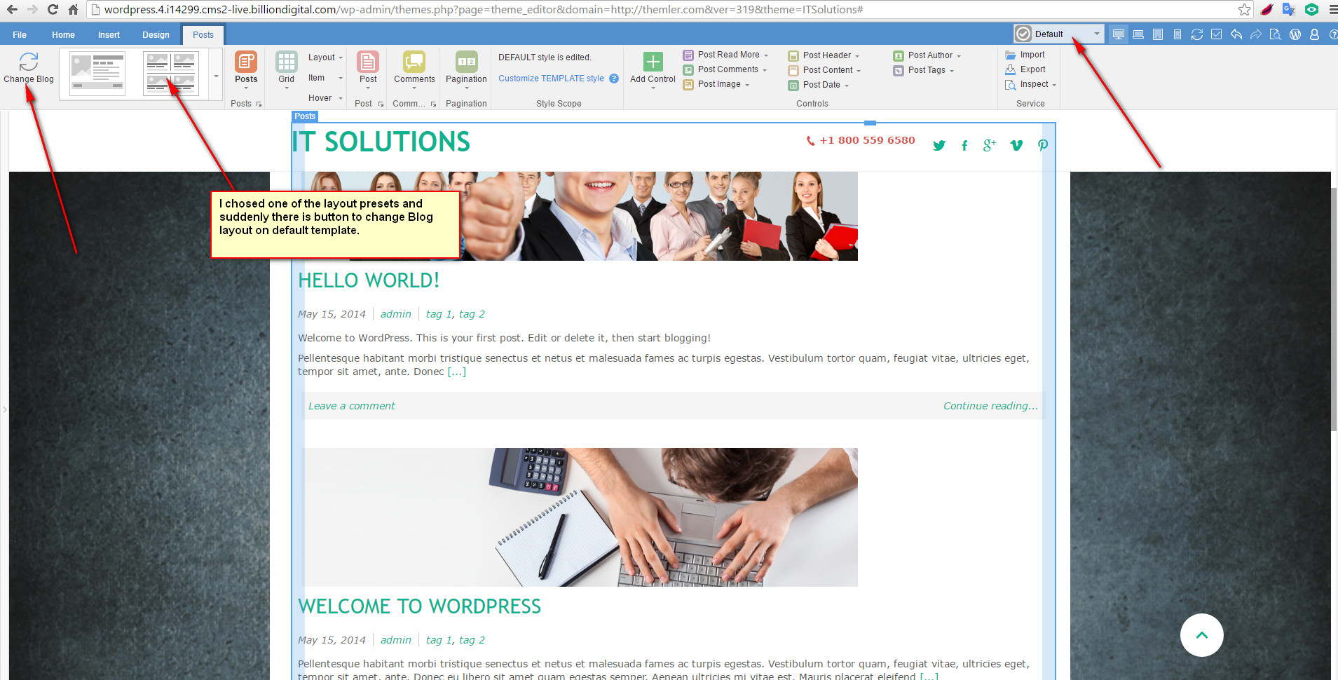

Just fact that "Change Blog layout" button is not visible on custom templates befora I chose first some layout from presets (top-left option) is very strange.
Here is how it goes. And here is how it changes Homepage template, you say it is not possible.
  • I make new custom template.
  • I change on both places "Customize template style".
  • I dont see yet button to change Blog layout from Clipart.
  • I click on something inside content, go to small window top-left and use one of TH presets for Posts layout.
  • Then suddenly beside this presets window I see button to change Blog layout for Posts (on my 100% custom template).

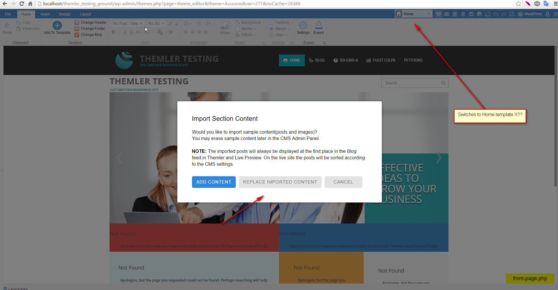

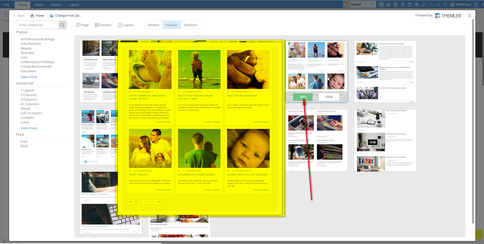

  • I click on it, go to Clipart and chose one.
  • Get message, import, replace, etc.
  • Chose one, something happens in background.
  • For a second maybe I see Blog template and warning it is not prepared in WP backend.

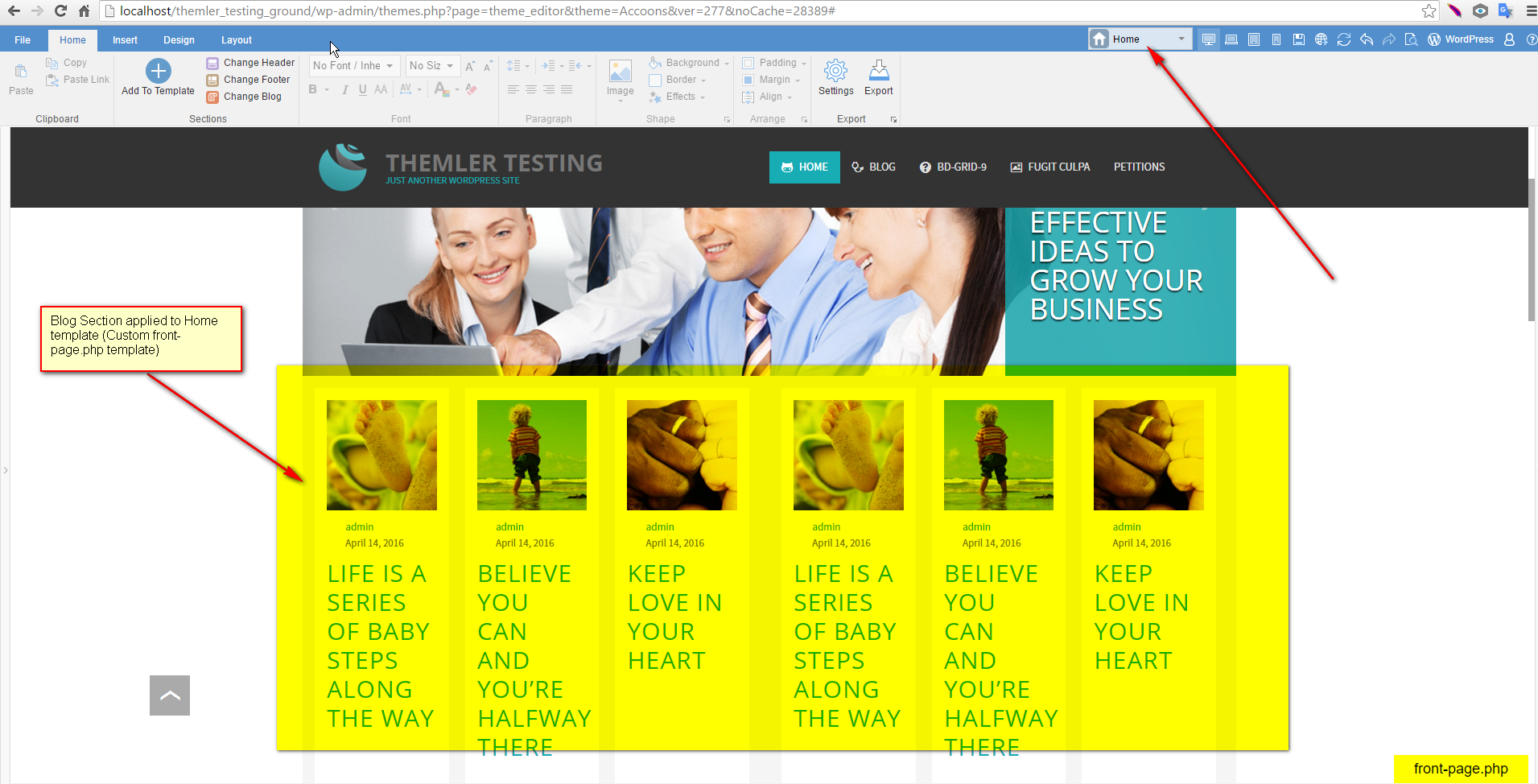

  • Then suddenly I im redirected from my 100% custom template to Home template and Blog layout from Clipart is changed on Home template. It is changed on both my custom template and Home, just I am redirected to Home.

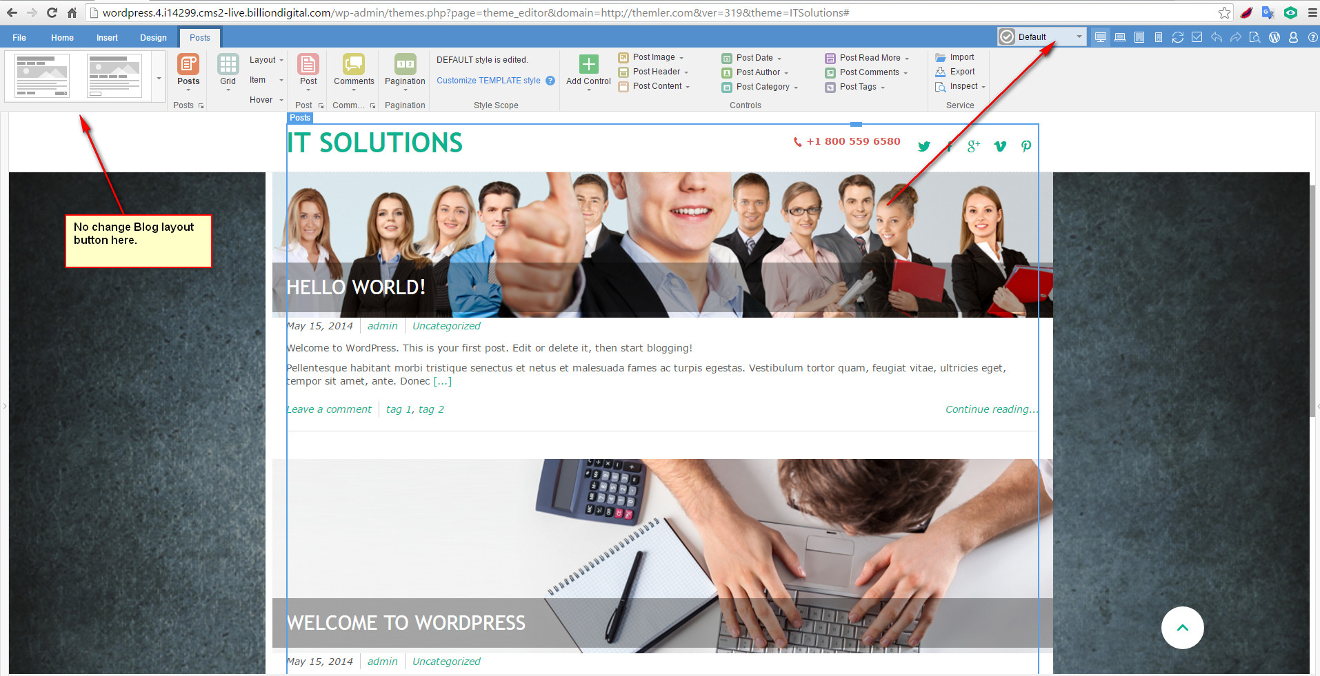

You see by screenshots that it is possible to change Blog layout from Clipart on default template.
So sort it out or give us video tutorial. I dont understand how it works.
http://attachments.answers.billiondigital.com/673/16673/2016-07-04-150751.jpg
http://attachments.answers.billiondigital.com/674/16674/2016-07-04-150853.jpg
You see by screenshots that it is possible to change Blog layout from Clipart on default template. So sort it out or give us video tutorial. I dont understand how it works. ![http://attachments.answers.billiondigital.com/673/16673/2016-07-04-150751.jpg][1] ![http://attachments.answers.billiondigital.com/674/16674/2016-07-04-150853.jpg][2] [1]: http://attachments.answers.billiondigital.com/673/16673/2016-07-04-150751.jpg [2]: http://attachments.answers.billiondigital.com/674/16674/2016-07-04-150853.jpg

The step #1 is "select Blog Template". I also mentioned a few times that Blog Sections are for Blog Template only. I also mentioned somewhere above that the fact that you see this option on other templates is a bug. It appears only when you switch to the template or apply preset and then it disappears as it should. This option changes Posts control layout on the BLOG template.
This is proper behavour because this option is not supported for Default, Home or Custom templates:
This is a bug that we'll fix in the future updates:
