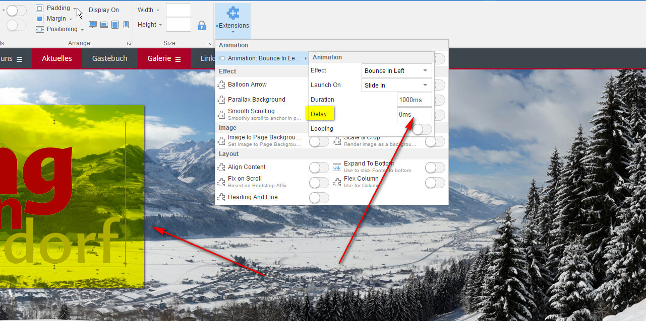

Put delay manually to 0ms ! In my case it was logo, but it is the same. Do it for all slides (all animated blocks).
enter image description here
Put delay manually to 0ms ! In my case it was logo, but it is the same. Do it for all slides (all animated blocks). ![enter image description here][1] [1]: http://attachments.answers.billiondigital.com/674/13674/2016-04-16-122058.png

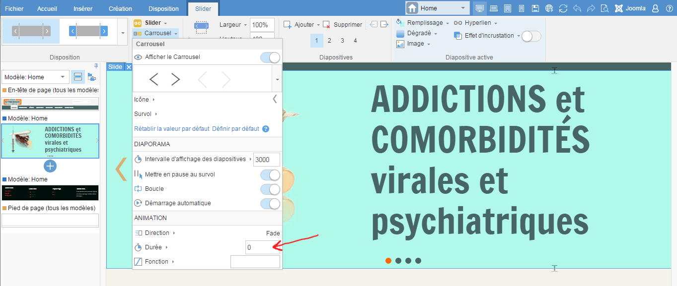

alibali
11 Posts
alibali posted this 16 April 2016
But the delay is at 0 since the beginning...
And we do not have the same interface. So maybe the behavior can indeed be different.
But the delay is at 0 since the beginning... And we do not have the same interface. So maybe the behavior can indeed be different. ![enter image description here][1] [1]: http://attachments.answers.billiondigital.com/675/13675/bug-slider-1.png
Stagger Lee
1818 Posts
Stagger Lee posted this 16 April 2016
Not in Carousel. Look at screenshot more careful. it is for Animation extension. Your blocks animated inside sliders.
You can have delay there in slider, no problem with it.
Not in Carousel. Look at screenshot more careful. it is for Animation extension. Your blocks animated inside sliders. You can have delay there in slider, no problem with it.
alibali
11 Posts
When the slider is selected, go to "Carrousel".
Put 0 for the duration and select any fonction of easing.
For me, it solved the bug!!!
When the slider is selected, go to "Carrousel". Put 0 for the duration and select any fonction of easing. For me, it solved the bug!!!
