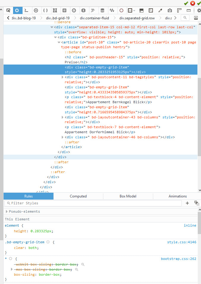

You can see it here. Added after Post Header, after Post content, after Text control,
http://attachments.answers.billiondigital.com/881/15881/2016-06-09-200013.jpg
You can see it here. Added after Post Header, after Post content, after Text control, ![http://attachments.answers.billiondigital.com/881/15881/2016-06-09-200013.jpg][1] [1]: http://attachments.answers.billiondigital.com/881/15881/2016-06-09-200013.jpg
