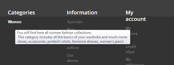

Hi,
In the default theme the one category item is shown.
enter image description here
We do use module that shows the category list, but not in the tree view, so you see all of them one by one.
Sincerely,
Hella

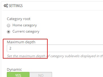

Hi,
Please try to activate the default PrestaShop theme and see if the issue is reproducible with it. If the issue persists that means that it is not related to the Themler theme and you need to investigate the problem further.
Also you can setup Categories Depth.
  1. Open Modules in You CMS admin.
  2. Find "Categories Block" module. Press Configure.
  3. Change "Maximum Depth" property.
Thank you,
Themler Team
