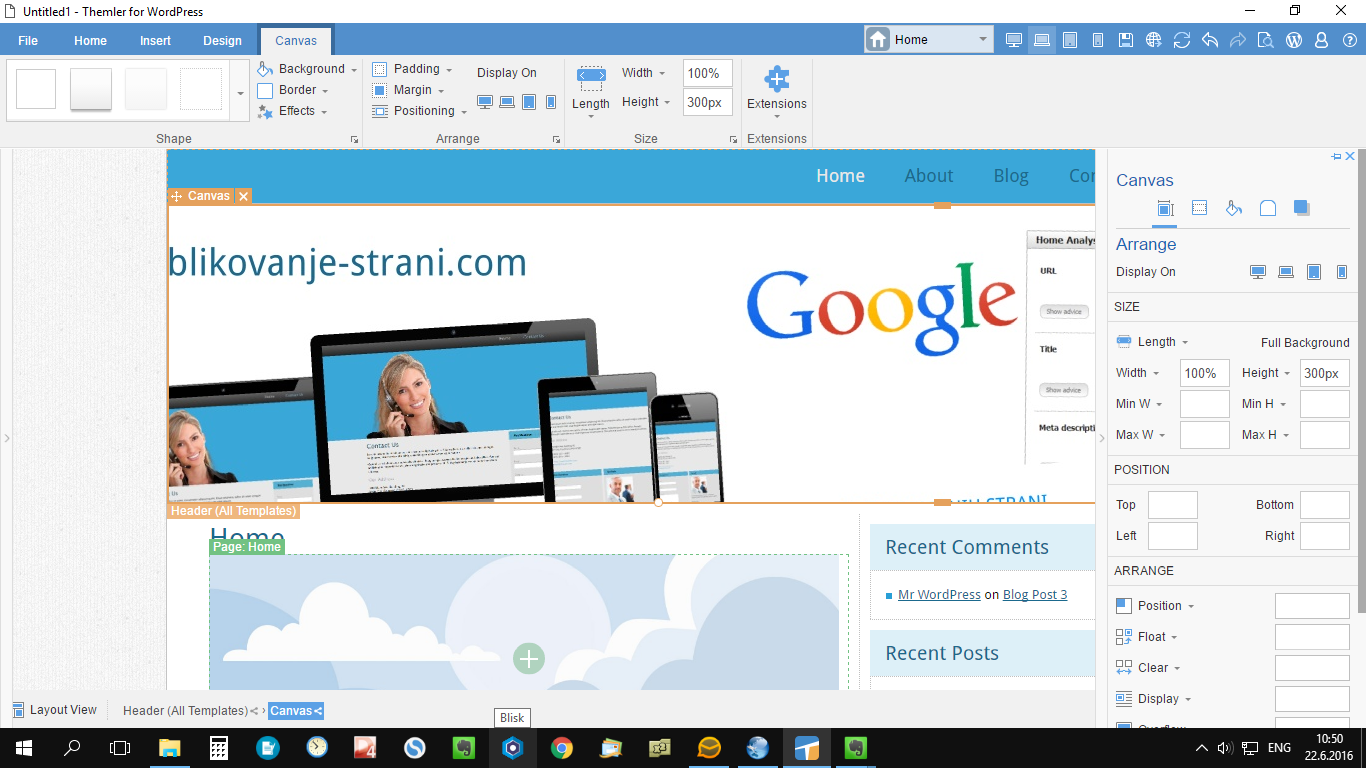

Hello
I installed new version of Artisteer, updated theme in Themler (desktop), but I do not have this option that you are showing - see prtscr
http://attachments.answers.billiondigital.com/263/16263/web3.png
attached also my theme
regards
Mike

Support Team
Support Team posted this 22 June 2016
Hi,
On the screen shot from the message above the third tab with the paint bucket is activated, on your screen shot you are on the first tab, please switch to the third one.

mike3000
24 Posts
mike3000 posted this 22 June 2016
Thank you, I did not notice :)
