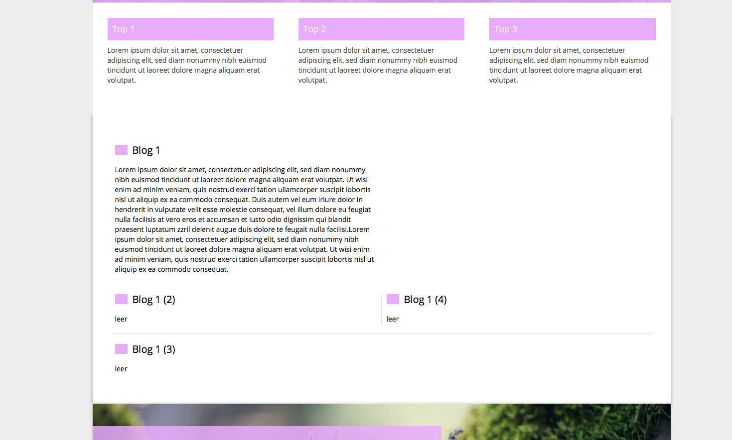

Hi!
I want to create at the blog theme 1leading blog. See attached
The leading Blog 1 should use the 100% of the content width. It is already set to 100% but it's still 50%
Hi! I want to create at the blog theme 1leading blog. See attached The leading Blog 1 should use the 100% of the content width. It is already set to 100% but it's still 50%!Bildschirmfoto-2015-03-27-um-11.45.18.png!

And i want to know how to set:
Currently i use 3 Joomla top modules. When i just activate 2 they should use the whole content width
50 / 50 %
When i have only 1 top modul
then automtically 100%
Is it possible?
And i want to know how to set: Currently i use 3 Joomla top modules. When i just activate 2 they should use the whole content width 50 / 50 % When i have only 1 top modul then automtically 100% Is it possible?

Hello,
I'm sorry for delay in response.
1. to output the Blog in the way you described please follow the steps:
- open Joomla admin back end, open the Blog menu link options >> Blog Layout and use settings like
- then open the theme in Themler, select Blog control >> Grid tab and make sure that 'Number of Columns' is empty for all modes
2.regarding the Joomla modules located in three columns. If you use Row with Columns control to locate Joomla positions, then the rows would have fixed width and they won't be wider or they won't hide if no module is assigned to certain position (like on your screenshot).
It is related to specific options of Bootstrap Grid that is used as base for Themler Rows controls.
Regards,
Aileen
Hello, I'm sorry for delay in response. 1. to output the Blog in the way you described please follow the steps: - open Joomla admin back end, open the Blog menu link options >> Blog Layout and use settings like !JoomlaBlogSettings.png! - then open the theme in Themler, select Blog control >> Grid tab and make sure that 'Number of Columns' is empty for all modes !ThemlerBlogSettings.png! 2.regarding the Joomla modules located in three columns. If you use Row with Columns control to locate Joomla positions, then the rows would have fixed width and they won't be wider or they won't hide if no module is assigned to certain position (like on your screenshot). It is related to specific options of Bootstrap Grid that is used as base for Themler Rows controls. Regards, Aileen

Hi!
So there is no way to get a result like with Artiteer for this case?
We have to work with fixed Bootstrap rows + colunms with no possibility for collapsing borders? Just to know; how i have to think about building my templates in future with Themler.

Hello Nadine,
for now there's no ability to "hide" empty table cell, so right now you may consider output anything "default" (for example text block) to avoid empty columns.
The next Themler update will include Sidebars control which include number of Sidebars. These sidebars could be hidden is they're empty on live page. I believe that it'd be a useful feature for your layout.
I cannot provide the exact update date, but it is expected in the next days. Please watch the announcements at this forum.
