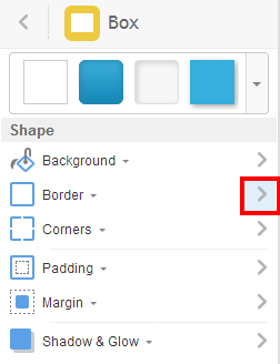

You can control the width of the Box control in the same way as the width of any other control which supports the width property:
  1. open Box properties in PW and go to the Custom Options:
  1. The last tab controls the size of the control:
You can type "100%" to stretch the Box to 100% of the column width.
