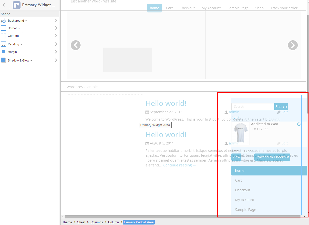

Hi Rory!
I have managed to place the Primary Widget Area in the right column. Please have a look to the screen shot:
alt text
When you drag the column make sure that the right vertical line is highlighted so the sidebar will be placed there. In any case the left column indeed remains empty. You can right click on it and choose Remove column option from the drop-down menu. That will delete the empty space.
But I also think that it should be removed automatically when the sidebar has been taken out.
